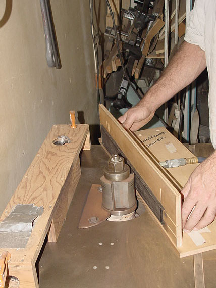

Hey JJ, here's a beautiful little set-up I've always coveted.
This is Jeff Traugott's custom made radiused cutter. (photo taken from Frets.com article on Mr. Ford's visit to Jeff's shop). Complete with vacuum to hold the FB in place.
You can't do compound, but I wouldn't mind...
Cool, no?
PostPosted: Tue Nov 21, 2006 8:36 am
Man, that scares the heck out of me...
PostPosted: Tue Nov 21, 2006 9:12 am
thats kind of cool .. but if I were him I would have got a small jointer, and had a set of blades custom ground for that instead - I heard thats how Gibson used to do them - makes way more sense (and its WAY safer) than doing it on a shaper. Plus, not that its a concern for Jeff, is that jointer can be a table top model, and easily be put away after use. I am sude Jeff has other cutters for this that do other jobs. I was in Larrivees shop years ago and he had a shaper jig that did the top face of a neck blank, icluding the headstock angle - it had a monster 4 or 5 inch cutter head on it .. some one could lose an arm on that sucker.

PostPosted: Tue Nov 21, 2006 9:53 am
I'm with you Don, That look like an accident waiting....
An ex employer of mine and cabinet shop owner lost 1&1/2 fingers with something just about like that. Those little digies never did grow back either.

Charlie's rig looks like a Williams & Hussey molding machine. That's a great idea, so long as the knives are really sharp. Still, you can't do a compound.

I don't quite understand the rub collar bearing setup on Jeff's shaper setup above. It almost looks like a "floating" ring backed up by a piece of radiused masonite.
Any thoughts? Just curious.
